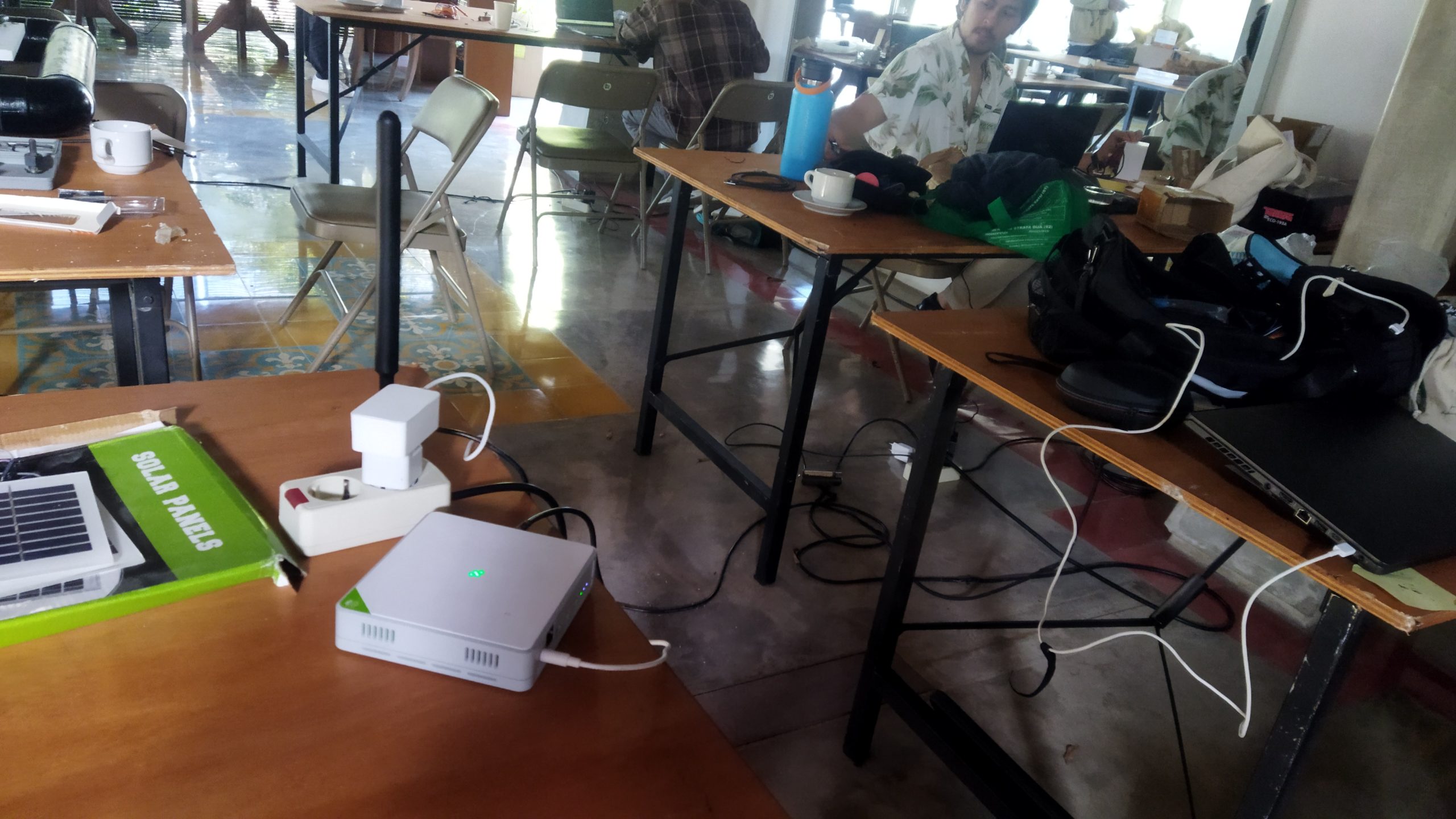

- Lokatani. The Idea of lokatani is they want to manage and monitor their existing hydroponic system. They already have the Grove Wio E5 on their hand but don’t have a gateway to test their application and device. Fortunately I bring my SenseCAP M2 multiplatform gateway for the event and guided lokatani using the packet forwarder feature from the gateway.

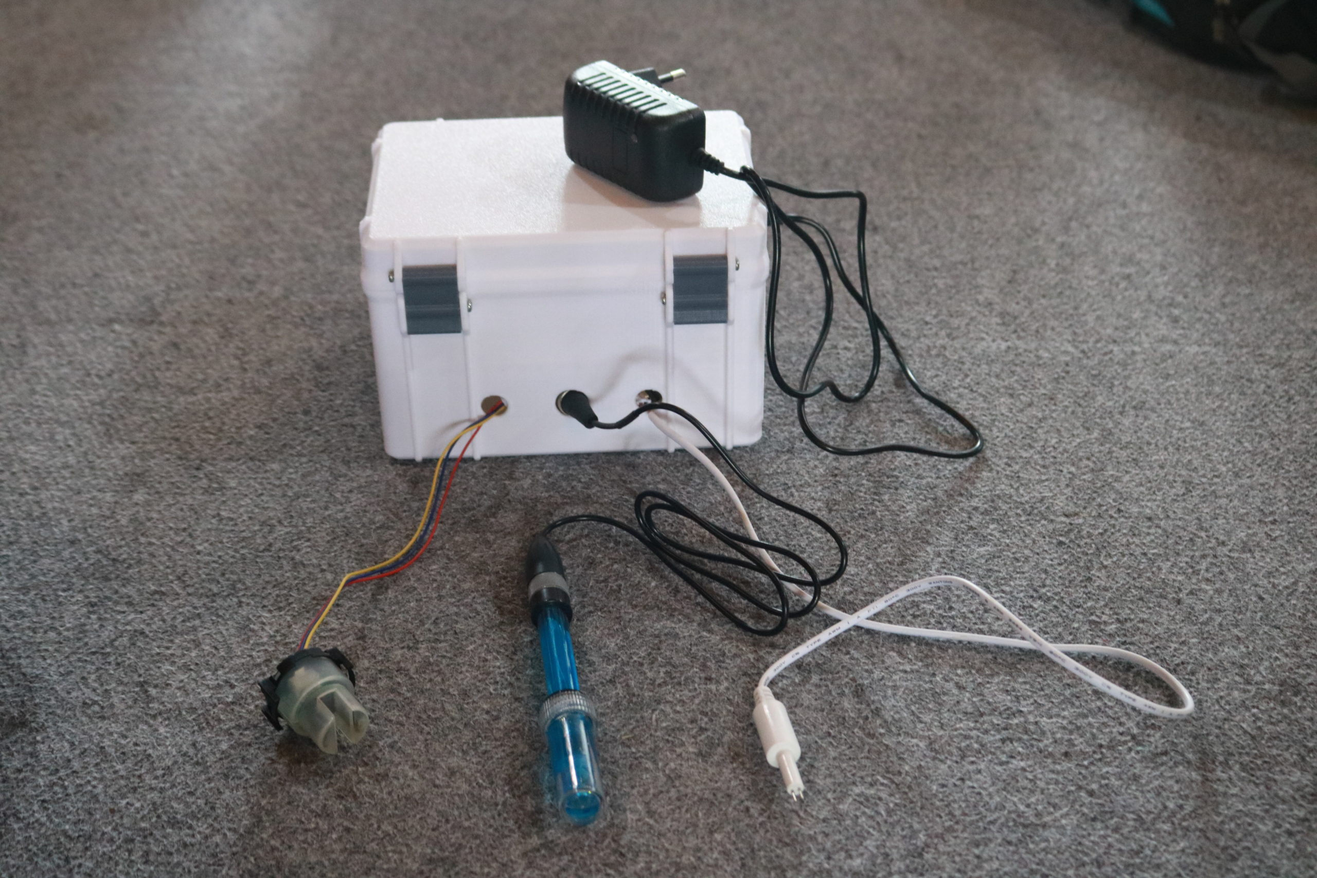

- Komodo water. The device that they want to build is an IoT-based water quality sensors aimed to measure and monitor important parameters such as temperature, dissolved oxygen levels, and pH in water to shift from manual monitoring operation. The person in charge of the device is facing difficulty to send the IoT Data to web dashboard, I helped him to use the Blynk platform and the Grove PH Sensor

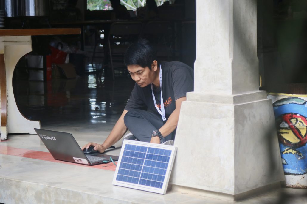

- Olat Maras. The startup already have an existing device which is a solar based cooler box but for this event they want to monitor the power usage of the devices. The person in charge at the event already have strong background in electronic but haven’t try arduino yet, So I help him to setup and code on an arduino environment using the XIAO ESP32C3

- Komodo Water facing some difficulties with the PH sensor not reading correctly, so I guide him to use the correct library while also stitching the codes for all the sensors used for his projects

- Lokatani wants to know about the mqtt feature on the Chirpstack from the SenseCAP M2 Multiplatform. So I explain a little about it and let him borrow my gateway for one day to test it

For this day the participants are given a chance to test their project at Kopernik’s office in Ubud Bali. I joined them to Kopernik office while also still helping a few participants that still facing some issues. Komodo Water still facing some issues in sending the data to the Blynk platform, in the end, they chose to display the sensor data on 20×4 i2c LCD display.
