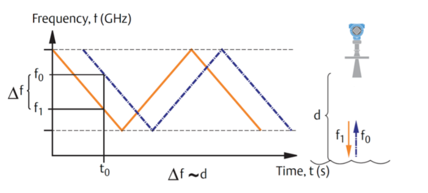

Frequency Modulated Continuous Wave (FMCW) Radar is a special type of radar sensor which radiates continuous transmission power like a simple continuous-wave radar.
Instead of using the time to measure distance (like TOF), FMCW technology emits a radar signal with a frequency that increases continuously to create a signal sweep. After being reflected by the process media surface, the signal’s echo will be picked up by the antenna. As the emitted signal is constantly varying in frequency, there is a slight difference between the frequencies of the echo and the emitted signals. This difference in frequency is directly proportional to the echo delay, thus allowing the accurate measurement of distances.
Level measurement scenario

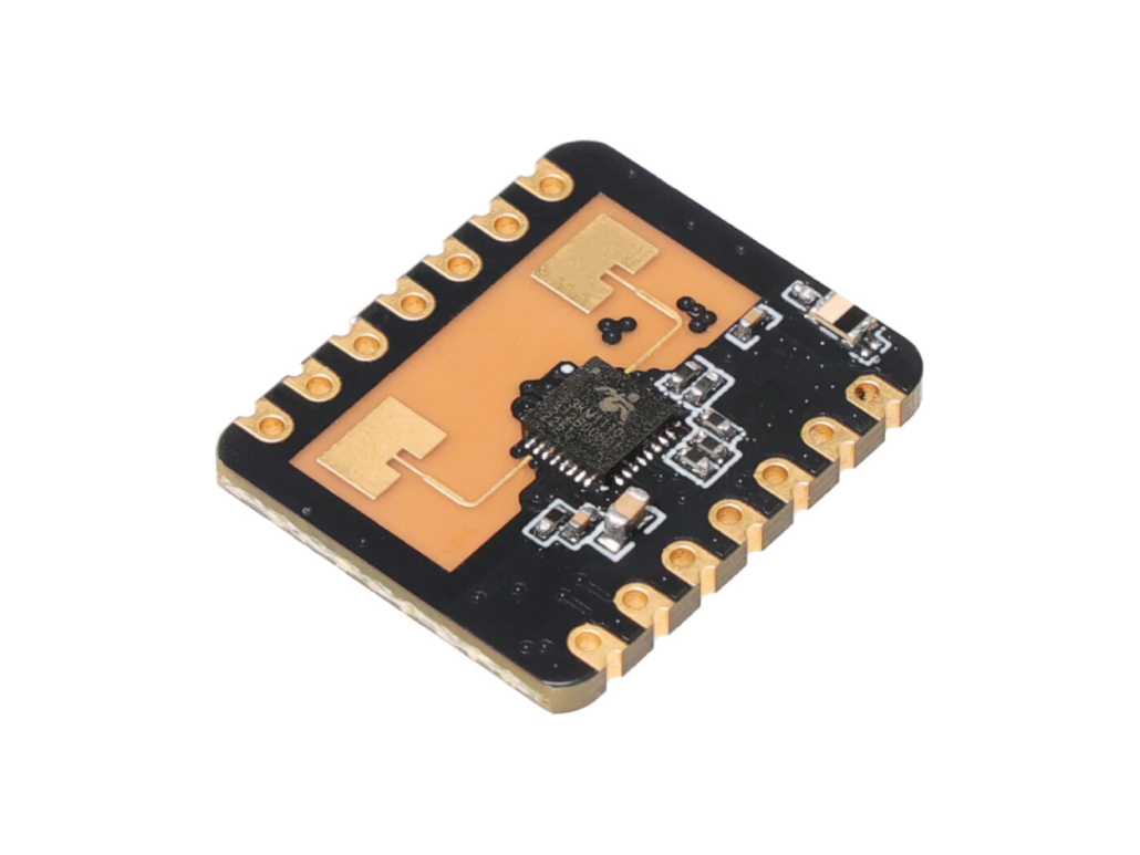

24GHz mmWave Sensor – Human Static Presence Module Lite is an antenna-integrated, high-sensitivity mmWave radar sensor that is based on the FMCW principle. It is user-friendly by providing visual debugging and configuration tools. It can flexibly adapt to various scenarios as multiple underlying parameters is configurable. With Arduino support, it is an easy-to-use and cost-effective choice for various human presence-detecting applications.
Key Features:
  • Based on the FMCW principle: highly sensitive and immune to environmental interferences
  • Visual debugging and configuration tools: straightforward and simple to use while keeping the data clearly presented
  • More parameter modulation options: multiple configurable underlying parameter settings to meet the different needs in various scenarios
  • Compatible with Arduino Library: adopts UART and provides Arduino library support
  • Home Assistant Ready: wiki to walk you through how to integrate it with Home Assistant

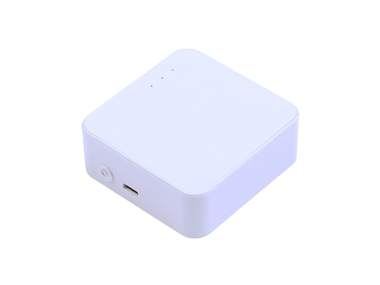

Ready-to-use mmWave Sensor Kit
mmWave Human Detection Sensor Kit $26.99
Powered by Seeed Studio XIAO ESP32C3, it supports Wi-Fi/BLE connectivity and offers precise human detection via mmWave sensors. Seamlessly connect grove modules for added features. Achieve easy setup for Home Assistant within 1-2 minutes, coupled with convenient wireless Over-The-Air (OTA) updates. Enable extensive versatility with replaceable mmWave sensors. Ideal for customizing smart home automation, detecting intrusions, and monitoring the well-being of the elderly.
