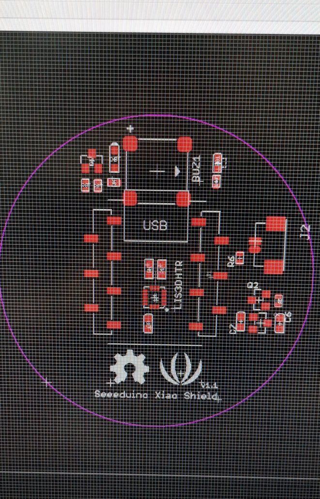

The best sensor for the task that will provide the data for machine learning model is obviously accelerometer. All of the XIAO series boards, being very small do not come equipped with accelerometer sensor. While we could use a XIAO expansion board for development and testing, it eliminates the low-footprint advantage XIAO boards have. If you are going to create your own product, the better option would be to create your own custom PCB board for the chip or SoM. I asked our hardware engineer to design a simple carrier board for XIAO, that would include LIS3DH accelerometer, a buzzer and a battery connector with a power switch.

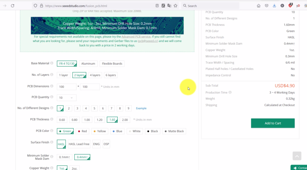

Then we used Seeed studio Fusion service to print some PCBA samples – for that go to https://www.seeedstudio.com/fusion_pcb.html and upload Gerber files, which contain the PCB design and choose the proper parameters for the board, such as number of layers, base material, minimum drill hole size and so on. We can see that a simple 2-layer board is approximated to cost 4.9 USD for 10 pieces plus shipping cost.

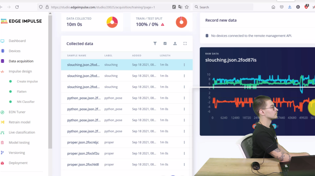

If you’d like to repeat the experiment without custom PCB, you can connect Grove LIS3DH accelerometer module to XIAO expansion board and start collecting the data. I collected 3 data samples for each posture, 60 seconds each with device attached to t-shirt on my back.
For each sample, I maintained the same pose, but included some arm, head and torso movements to simulate normal activity.

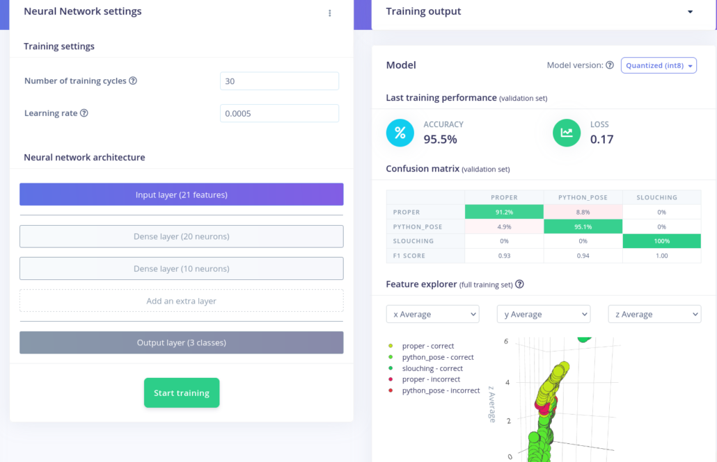

I have chosen 5 seconds time window with window shift of 1 second and Flatten processing block, since we are dealing with very slow moving data. A very plain fully connected network provided a good accuracy. Here is the link to public version of the Edge Impulse project.
Some improvement can be made by collecting more data and making sure proper and improper postures can be recognized with some variations in device positioning on the clothes. Since the device is thought to be individual usage device it does not need to generalize to different people’s postures and can be easily re-trained. You can check how well it detects your postures after training in Live classification tab.
