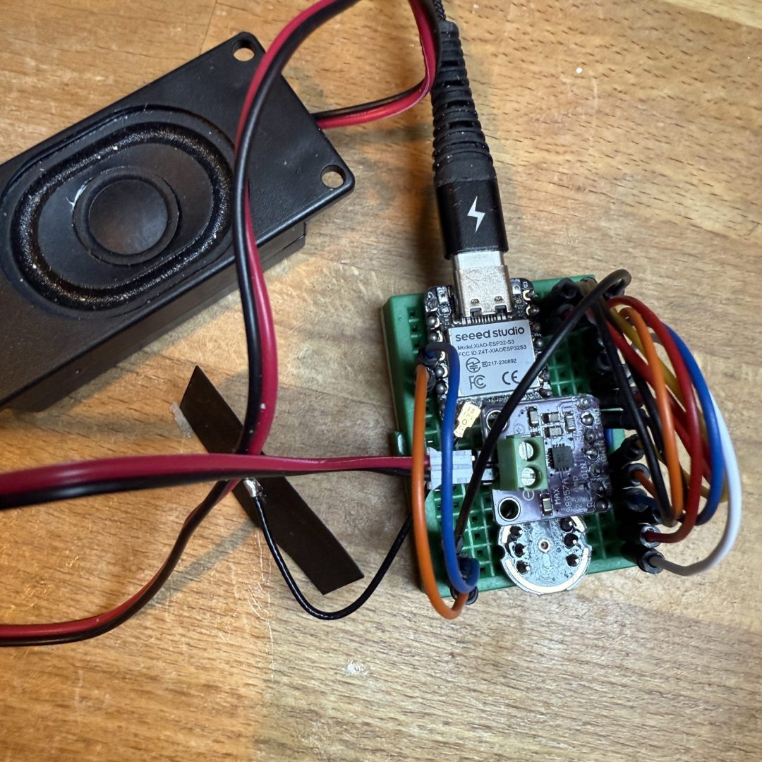

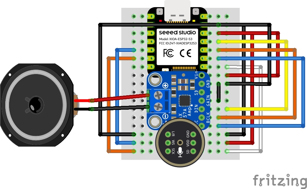

    • Seeed Studio XIAO ESP32S3
    • INMP441 I2S microphone
    • MAX98357 I2S audio amplifier breakout board
    • 3W 8Ω speaker
    • 3.7V 300mAh 602030 Li-Po battery or similar (for stand-alone use)
    • On-off switch (for stand-alone use)
    • Mini breadboard

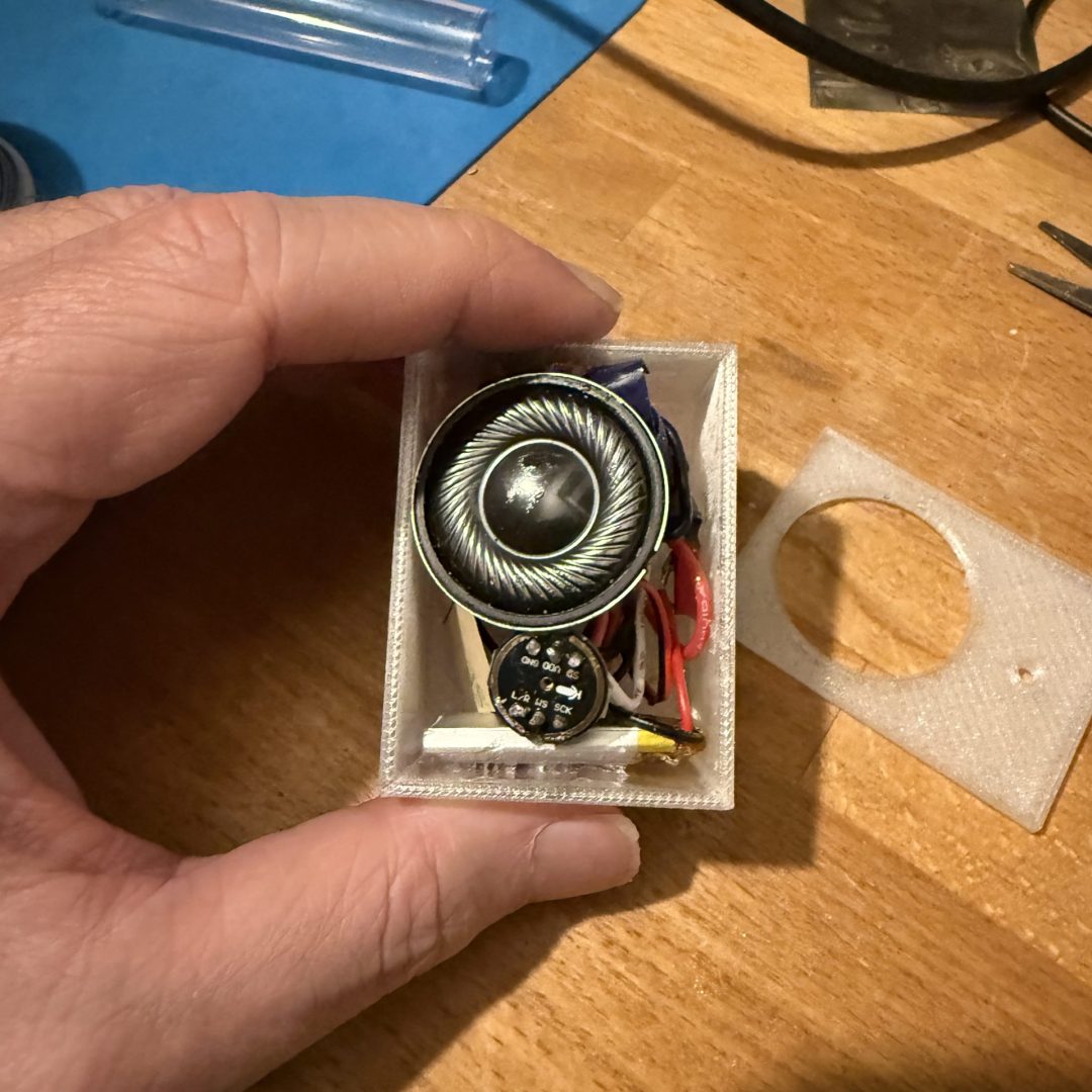

MiniMe combines speech recognition, generative AI, and voice cloning into one seamless, compact device. It starts with voice activation — no buttons necessary. When it hears your voice, the INMP441 microphone captures the audio and sends it to OpenAI’s Whisper API for transcription. That transcribed text is then passed through a customized ChatGPT setup, enhanced with a simple RAG (retrieval-augmented generation) layer. This layer checks a keyword-based database stored on the microcontroller’s SPIFFS filesystem, pulling relevant biographical context and prepending it to the user’s query. The personalized prompt is sent to ChatGPT, which generates a response that’s not just smart, but sounds like “you.” This response is converted back to speech using ElevenLabs’ text-to-speech API — complete with a cloned voice — and finally played aloud through a tiny 3W speaker powered by a MAX98357 audio amplifier.

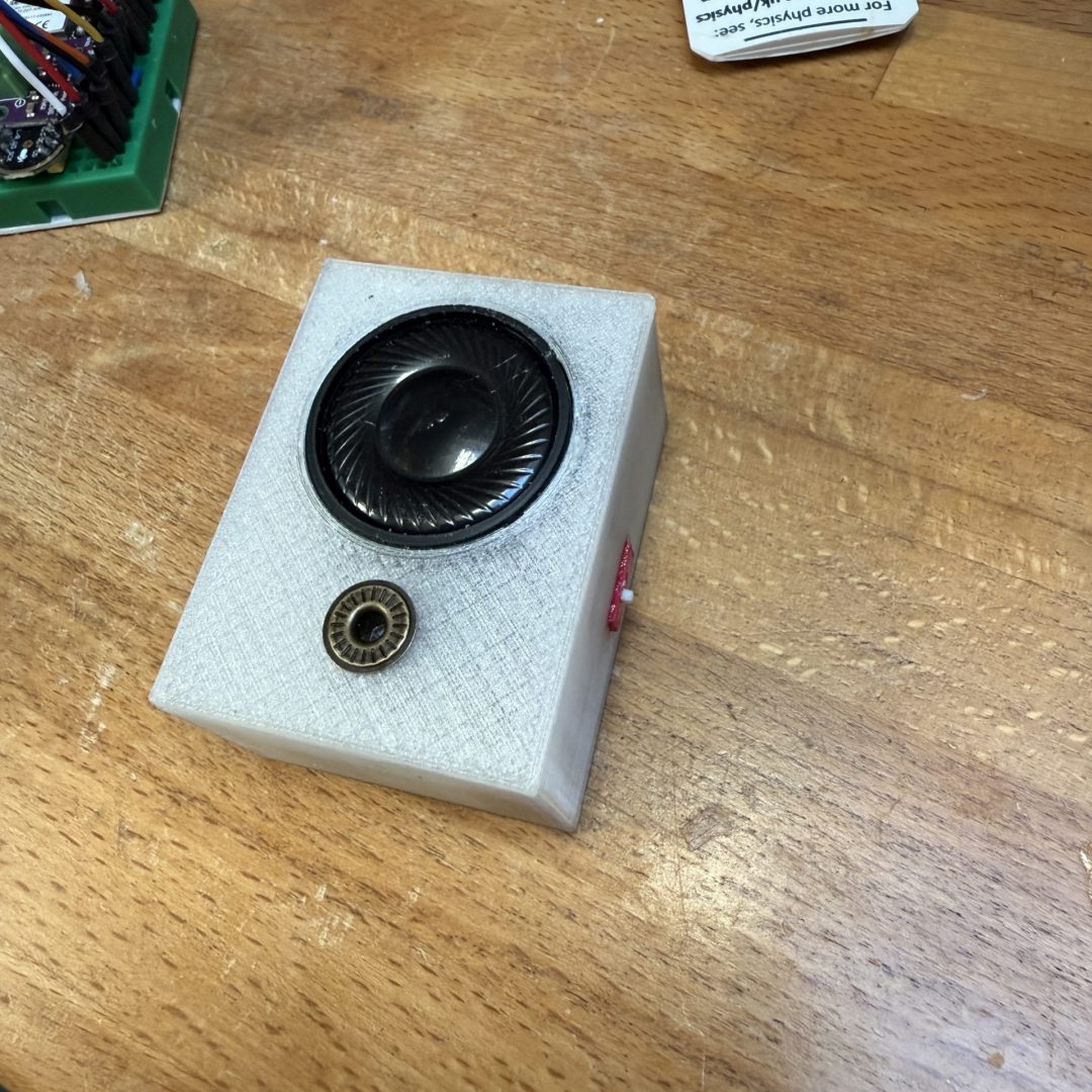

All of this runs smoothly on the XIAO ESP32S3, which also handles battery management and storage. With no SD card required and everything packed into a tiny 3D-printed enclosure, MiniMe is both a technical feat and a glimpse at the potential of personal AI in your pocket.

Curious to create your own AI twin? Michael has made it easy — the full code, hardware layout, and STL files are available on his GitHub. Whether you’re building a mini-you or a personalized AI companion, the project offers a fascinating glimpse into what AI and microcontrollers can achieve together.
