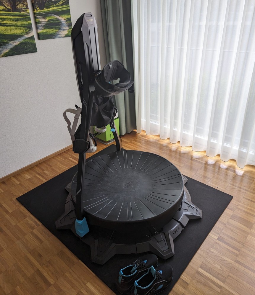

By Kezang Loday 11 months agoIf you’re a passionate virtual reality gamer, you might be very familiar with the super cool gadget KAT VR Treadmill, an advanced virtual reality locomotion device that allows users to walk, run, and move “freely” in any direction within VR environments. However, the original receiver requires a connection to a power socket, which somewhat contradicts the idea of a completely free VR gaming experience

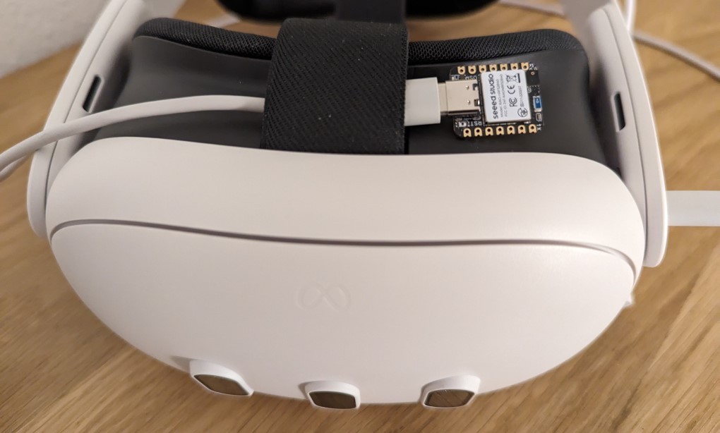

To ensure a 100% wireless VR KatWalk experience, developer Anton Fedorov turned a XIAO nRF52840 into a KatVR C2/C2+ Bluetooth Receiver as a new alternative. This new receiver eliminates the need for cables, allowing for a more immersive and unrestricted VR experience. It connects directly to the KatVR’s C2/C2+ treadmill sensors and can be used with a PC or Oculus headset, enhancing your VR experience with reduced latency and smoother performance. This open-source project is hosted on GitHub and offers a comprehensive guide for DIY enthusiasts.

The KatWalk Receiver serves as the central hub for wireless communication between the treadmill and the VR setup, ensuring seamless data transmission and synchronization. The nRF-based KatVR C2/C2+ Receiver project revolutionizes the traditional KatVRreceiver with a custom-built Bluetooth receiver using the XIAO nRF52840 microcontroller. This innovative receiver connects wirelessly to the KatVR treadmill sensors, capturing data from the foot and direction sensors at an impressive frequency of 100Hz, compared to the original 86Hz. Utilizing Bluetooth Low Energy (BLE) for communication, the microcontroller processes data with custom firmware developed on Zephyr OS, a robust real-time operating system. By bypassing the traditional GATT client to handle raw ATT packets directly, the project optimizes data processing and significantly reduces latency.
Additionally, the receiver emulates the original KatVR receiver’s USB HID interface, ensuring seamless integration with the existing KatVR system and providing users with a more responsive VR experience. The project enhances user-friendliness by storing sensor settings in non-volatile memory, eliminating the need for repeated pairing. Furthermore, the firmware supports dynamic updates of the USB PID and serial number, ensuring compatibility across various KatVR hardware versions. For a detailed look at this project in action, check out the testing and demo video on YouTube by Oshev.
