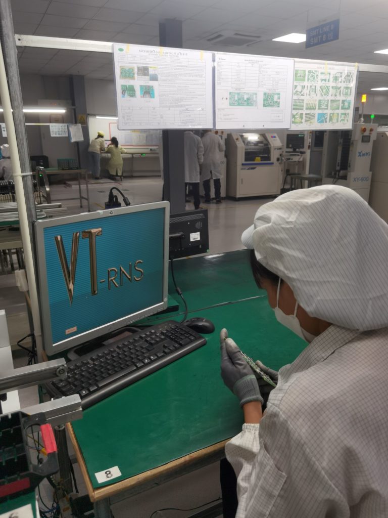

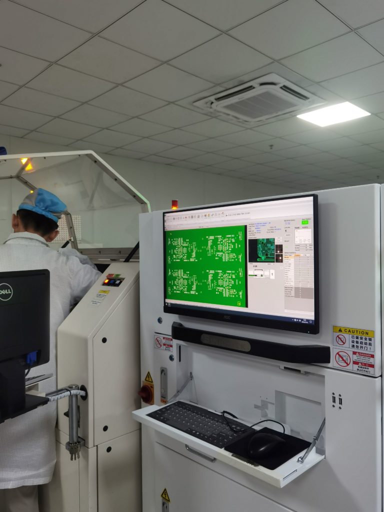

5. Automated Optical Inspection (AOI)
After soldering, the board is subjected to cleaning and quality inspection to identify any defects. Automated Optical Inspection, also know as AOI, is a process used in manufacturing to inspect products or components using high-resolution cameras and software programs. It can identify issues such as missing components, incorrect component placement, or soldering defects.
6.X-ray Inspection
X-ray inspection is to penetrate non-metallic substances in objects through X-rays without damaging the object being inspected. This technique is used to detect faults such as the quality of BGA component soldering and whether there are any short circuits present. While AOI uses high-resolution cameras to detect faults in products or components’ external surface, X-ray inspection penetrate products or components’ internal structures, such as detecting short circuits, missing solder, and other defects in products like lithiumion batteries and IC chips.
Both of the inspection processes are critical, especially for high-volume production, as it allows for quick detection and correction of any manufacturing defects.

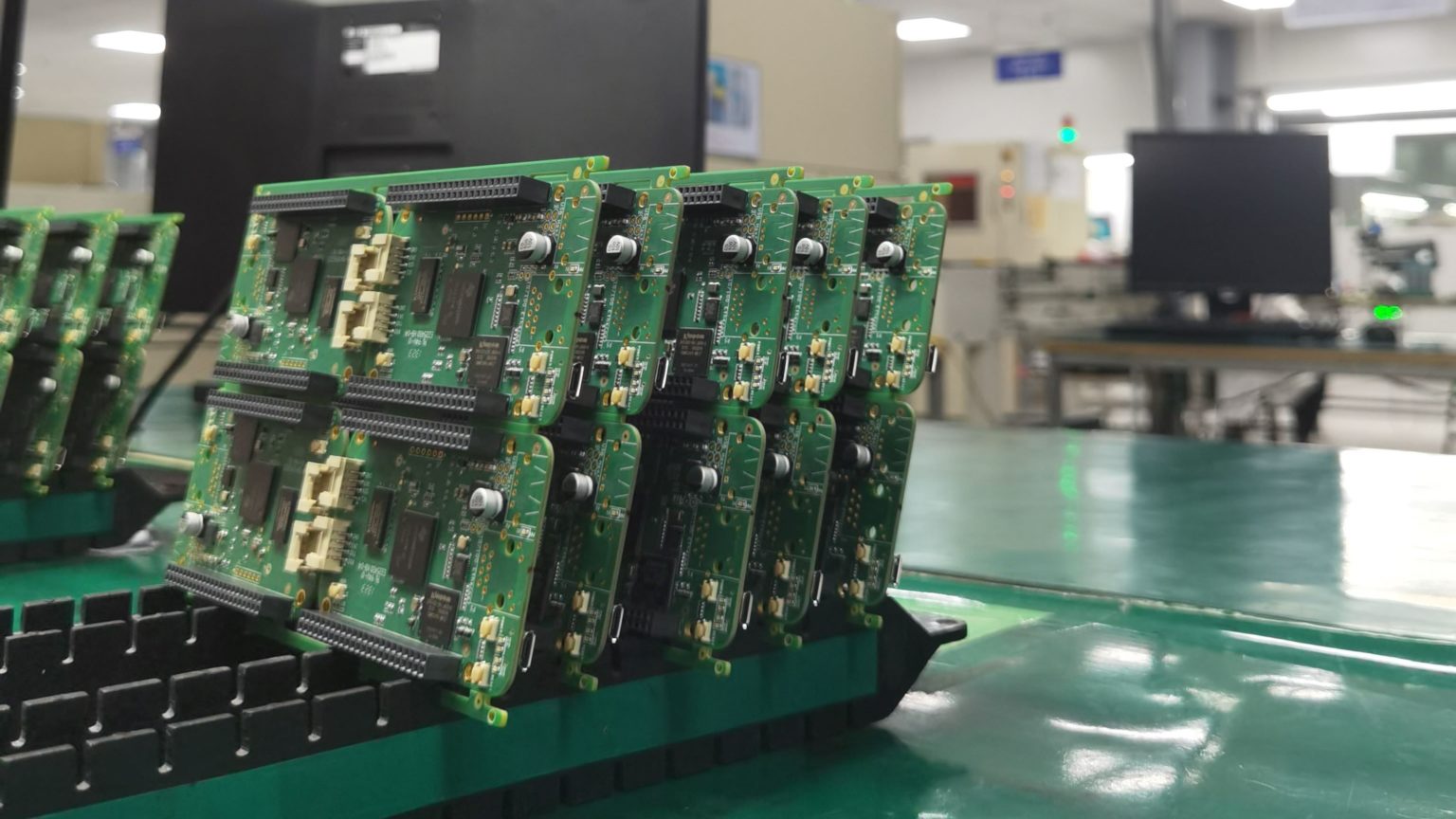

7. DIP & Wave Soldering
Dual In-line Package (DIP) and wave soldering are additional steps in the manufacturing process used for through-hole components. DIP is a type of through-hole technology that uses a DIP socket to put in electronic components such as resistors and diodes. Wave soldering is a process that uses a molten solder wave to solder the through-hole components onto the PCB. These processes ensure that the through-hole components are accurately and securely mounted onto the PCB to produce a reliable and functional electronic device.

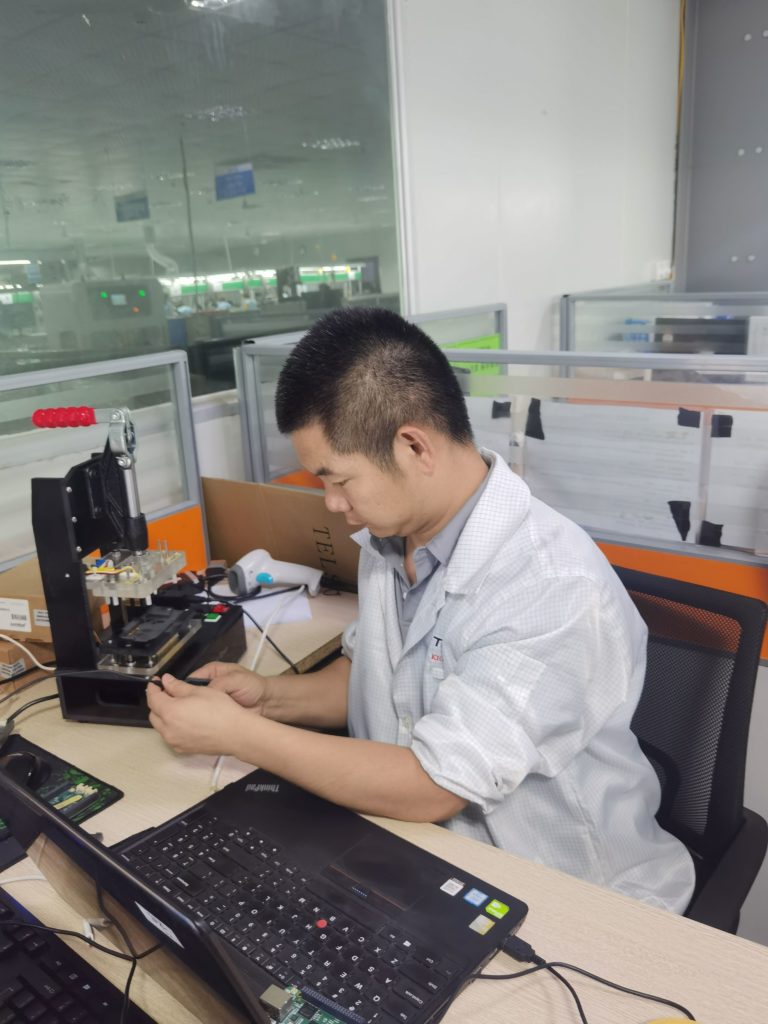

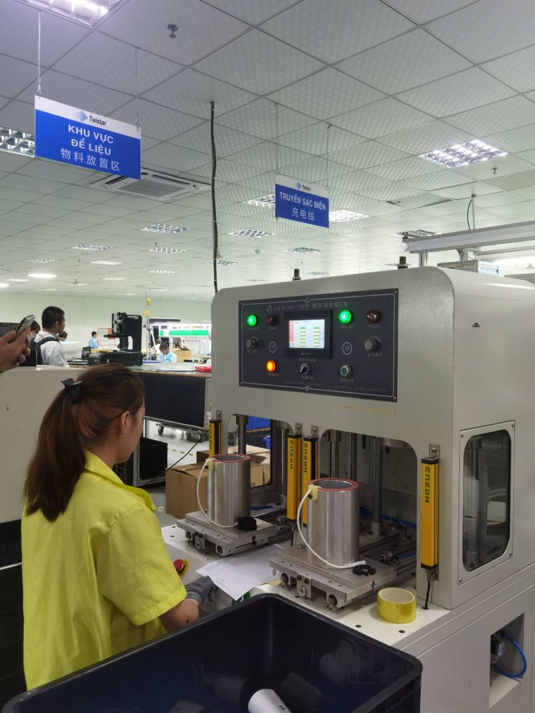

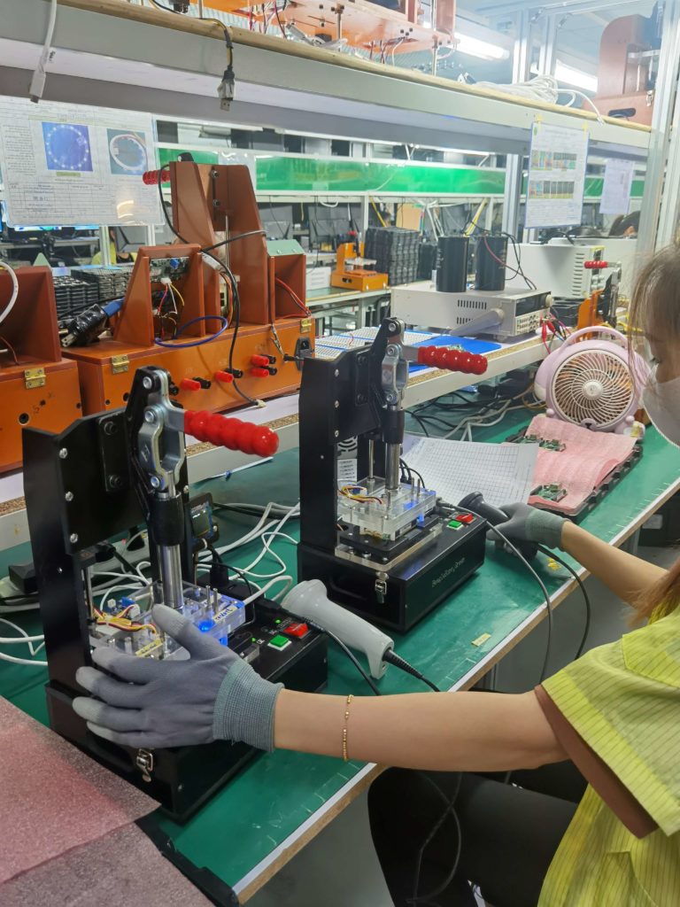

8. Functional Testing & Quality Check
We are almost there! Now you can see the semi-finished BeagleBone Green. The final stage is functional testing. These tests examine the complete assembly instead of individual components, guaranteeing that the products will operate appropriately. They act as the final stage between manufacturing and the market, ensuring the product is of high quality, reliable, and ready for distribution.
