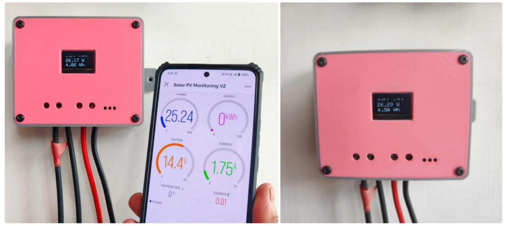

12. Field Testing
To field test the device:
  1. Connect the load’s negative terminal to the output negative terminal, and positive terminal to the output positive terminal. Connect the output terminal to the inverter.
  2. Connect the solar panel’s negative terminal to the input negative terminal, and positive terminal to the input positive terminal.
Use wire sizes from 26 – 10 AWG for the input and output screw terminals.
Note: Ensure correct polarity to avoid damage. The circuit does not have reverse polarity protection.
Once connected, check the solar panel parameters on the OLED display and on the Blynk app on your smartphone.
