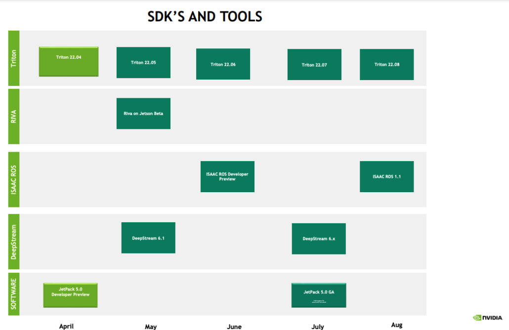

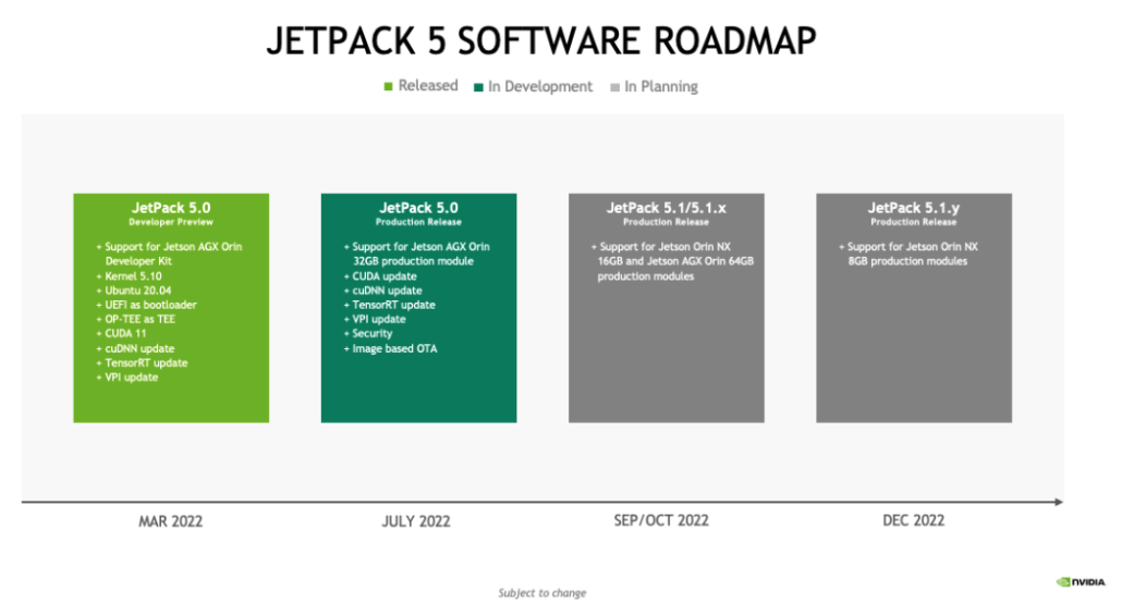

Let take a look at key takeaways from the webinar and current Jetpack 5.0 release infomation. Noted Jetpack 5.0 Production release for Jetson AGX Orin 32GB production module will be available in July as NVIDIA Jetson software roadmap listed.
In April, NVIDIA launched JetPack 5.0 Developer Preview. This is a development release with a full compute stack update including CUDA 11.4, as well as Jetson Linux 34.1 with Linux Kernel 5.10, an Ubuntu 20.04 based root file system, a UEFI based bootloader, and OP-TEE as Trusted Execution Environment.

Features not included yet but will support Jetpack 5.0 Production Release
- Support Jetson AGX Xavier Industrial Module
- Secure Boot and disk encryption
- Image-based over-the-air updates tools
- Rootfs A/B
- OP-TEE on Jetson AGX Orin (Jetson Xavier NX and Jetson AGX Xavier series support it)
- Jetson Xavier NX SD card updating the Xavier NX SPI components
- Flashing an SD card image for a Jetson Xavier NX Developer Kit out of the box (you can flash an SD card image after you have flashed the developer kit with SDK Manager)
