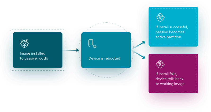

When you push an update from the Mender server to the remote device, mender client on the device will download the image and write the image to the rootfs partition that is not running. Then it will configure U-Boot to boot from the updated rootfs partition.
vAfter that the device will reboot and try to boot from the updated partition. If the update gets corrupted due to power loss during the process or due to any other reason, the device will boot from the original partition that was running before. This will ensure that the device will be booted exactly the way it booted in the original working state.
If the update succeeds, the update partition will be set to boot permanently when mender starts as part of the boot process. Now the previous passive partition has become the active partition.
