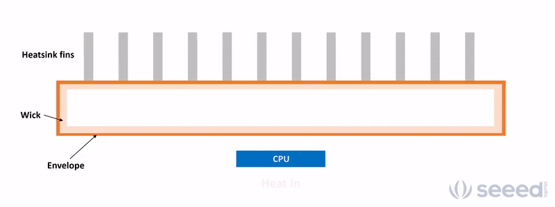

A vapor chamber consists of a vacuum in a sealed vessel, or envelope such as copper, that is lined with a fine wick structure and contains a small amount of working fluid, typically water that is in equilibrium with its vapor. The chamber can contain internal support structures to prevent the chamber walls from collapsing or expanding under high heat loads. Wicks can be made from a fine mesh or fiber material such as powdered copper welded onto the inner surface or consist of a series of embossed shapes or grooves directly on the copper envelope itself.

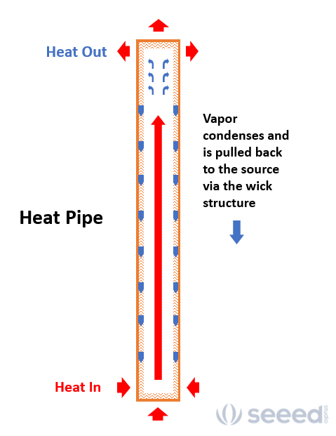

The working principle of vapor chambers is essentially the same as heat pipes but in a different geometry, and the two share many similarities.
Working principle of a vapor chamber and a heat pipe
When one end of the heat pipe or side of a vapor chamber is heated by a source, an IC for example, the working fluid evaporates and the vapor travels at high speed to the other end of the heat pipe, or laterally across the vapor chamber. As the vapor cools, it transfers its stored energy to the envelope, which then either directly dissipates to the environment or conducts to additional cooling devices such as a solid copper or aluminum heatsink. Upon losing its energy, the vapor condenses back into a liquid onto the wick structure, which then transports the fluid back to the heat source via capillary action – imagine a dry kitchen towel absorbing a drop of water. The cycle then repeats. The result is high-speed heat transfer and a low temperature gradient across the heat pipe or vapor chamber.
Heatpipes and vapor chambers are known as passive two-phase devices. They use the high latent heat of the working fluid, or the energy required to cause a phase change from liquid to gas and vice versa, as a means of storing energy, then use the strong pressure difference across the envelope to transport energy at speeds hundreds of times faster than solid conductors. Copper is one of the best metal heat conductors with thermal conductivity of around 400 W/(mK) (watts per meter-kelvin), however passive two-phase devices have effective thermal conductivities of 3200 to 200,000W/(mK) depending on the type of wick structures, working fluid and the design of the inner chamber.

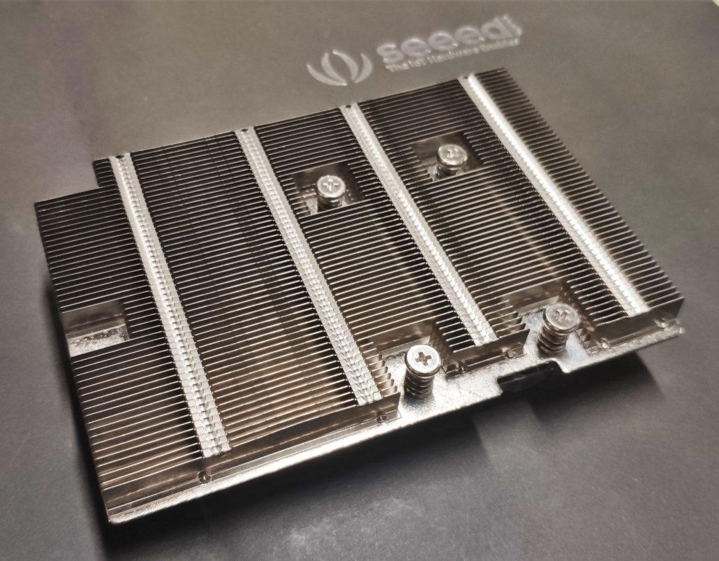

Seeed reServer vapor chamber. Silicon grease has been applied where the vapor chamber contacts the IC.
Seeed’s reServer has a large 2 piece vapor chamber heatsink (VCH) with an area measuring 136 x 92mm in size, about the same size as a 3.5-inch hard disk drive. The outside exoskeleton is made of aluminum and encases the copper vapor chamber. The vapor chamber has rows of structural supports, whose indentations are slightly visible on the aluminum surface. These supports and the casing allow the chamber to withstand high clamping pressures and deformation under high temperatures.
A small area similar in size and shape as the Intel® Core™ chip protrudes out from the vapor chamber side and a spring-loaded screw sits on each corner. The screws can be tightened to ensure a tight and uniform fit between the VCH and the IC. A zipper fin heatsink is bonded directly on the other side of the vapor chamber with the vapor chamber serving as the base of the heatsink, further reducing volume.
Under certain lighting conditions, the rows of the structural posts are visible
The vapor chamber spreads the heat from the small area of the IC throughout the vapor chamber where it then conducts through the fins of the heatsink. A large fan at the base then pushes the air out of the perforated bottom. All these thermal management elements work together to provide exceptional cooling performance compared to other solutions.
Zipper fin heatsink bonded directly to the vapor chamber

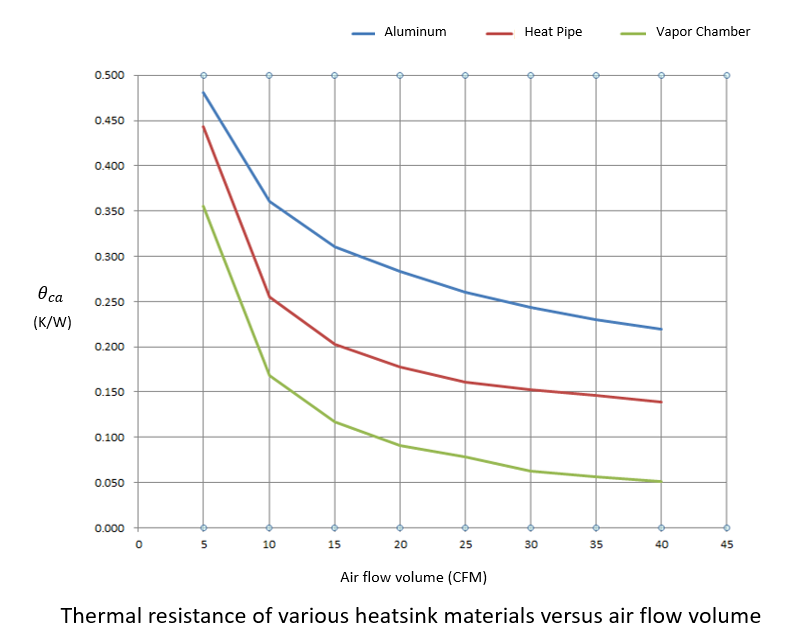

The following chart shows the performance of three cooling solutions; a basic aluminum extrusion heatsink, heat pipe fan stacks and vapor chamber heatsink combination for the same volume.
Clearly, the vapor chamber offers much lower thermal resistance compared to the other technologies. Switching from the aluminum heat sink to heat pipe fin-stack, to the vapor chamber saw consistent reductions in the case to ambient thermal resistance across a range of airflow volumes, decreasing it by over two-thirds in some cases (68%). This superior performance allows reServer to run at higher power over long periods, perfect for long life and uninterrupted service.
