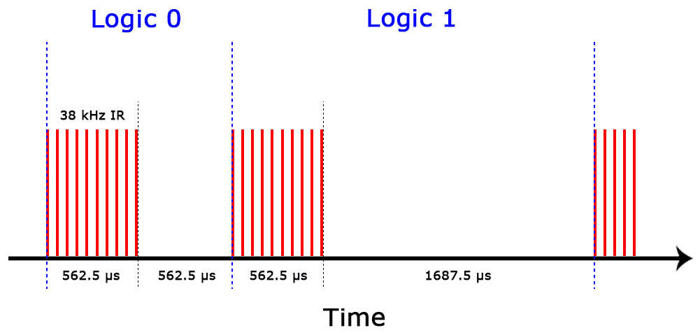

IR Communication: Transmission Protocols
Because storing the precise timing of the entire signal as 16 bit integers takes up too much memory, IR signals are usually stored as binary numbers of up to 32 bits. At transmission, an IR emitter converts this binary number into the actual IR signal, whereas on the other hand, an IR receiver will decode the received IR signal into the corresponding binary number.
The pattern through which the IR signal is converted to and from binary is known as the transmission protocols. Some of the more common protocols include Sony, NEC, Matsushita, and RC5.
In the NEC protocol, for example, logical ‘1’ starts with a 562.5 µs long HIGH pulse of 38 kHz, followed by a 1687.5 µs long LOW pulse. Meanwhile, logical ‘0’ is transmitted with a 562.5 µs long HIGH pulse followed by a 562.5 µs long LOW pulse:
