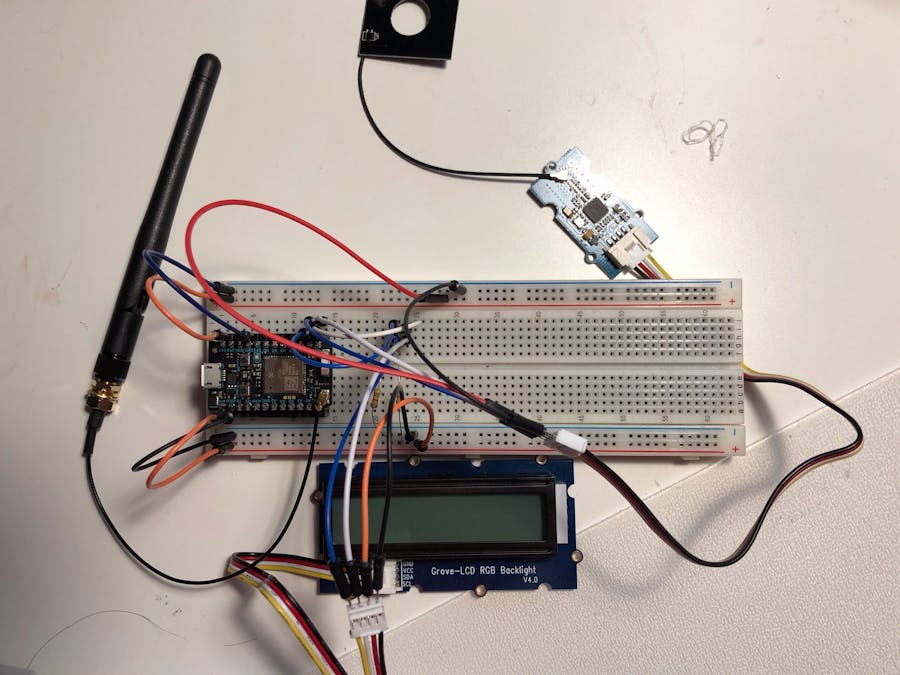

Particle Photon + Grove NFC + Grove LCD via I2C
With most of the tutorials on Photon and NFC using SPI and RC522 Modules, this tutorial helps you read out the UID of an NFC card!
What do you need?
Interested? Check out the full tutorial by An Tran on hackster.io!
