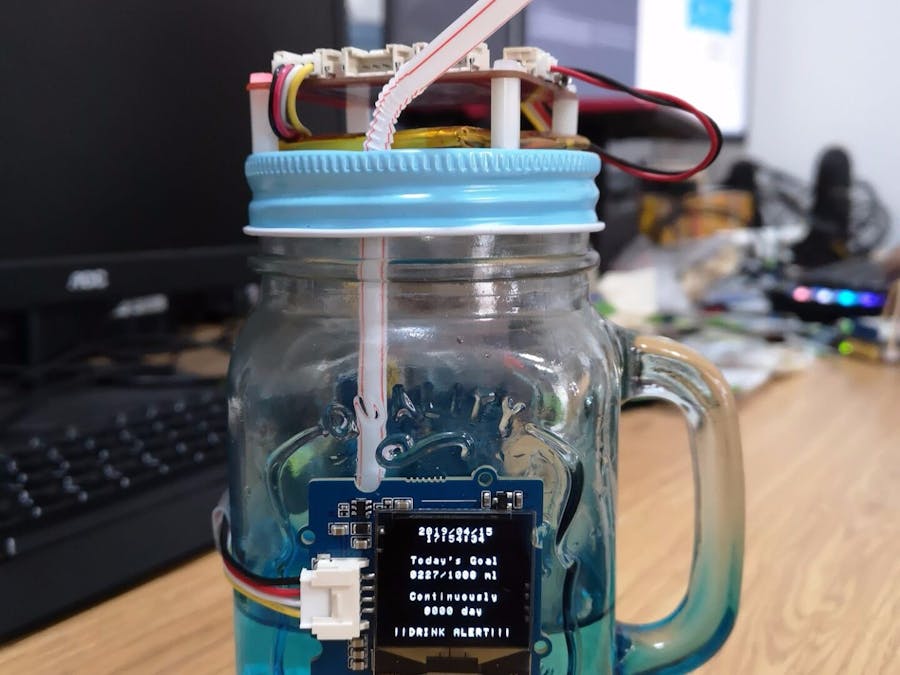

Drinking Reminder Water Bottle
Do you often forget to drink water when you are busy? With this project, you can create a drinking reminder to alert you to drink water! With the ultrasonic sensor, it is able to detect the changes in the water level in the bottle and also calculate how much water was drunk!
