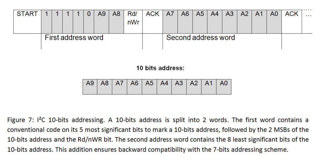

10-bit device address
- I2C normally has a 7-bit address and there are only 127 different I2C devices. However, in reality, there are way more types of I2C devices and an I2C device has a high chance of having the same address on a bus.
- In order to overcome this limitation, many of the devices use dual address through external configuration pins and also a 10-bit address scheme.
- The 10-bit address scheme has two effects on the normal I2C protocol:
- The address frame now has two bytes instead of 1 byte.
- The first five most significant bits of the first byte is used to identify the 10-bit address with the convention being “11110”.
- I2C also have addresses that are reserved for special purposes
